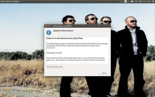

Today after finishing the update i got update information
I have tried clicking on run action now, but by that nothing happens only terminal opens up and then after minute it automatically closes down.
NOTE:I have seen question related to this, but not sure to use solution as there was pepflashplugin installer while in my case it is only flashplugin installer

I had the same problem and have fixed it with the following two steps from the command line:
  1. Removing flashplugin-installer completely with the following command
    sudo apt-get remove --purge flashplugin-installer
  2. Re-installing flashplugin-installer again with the command
    sudo apt-get install flashplugin-installer

Another command to force the download to be reattempted:
sudo pkexec /usr/lib/update-notifier/package-data-downloader
I just got this to work in 16.04. This way you don't have to uninstall/reinstall the package. It's the same thing that would happen if you click the "run this action now" button in the GUI.
Running sudo pkexec /usr/lib/update-notifier/package-data-downloader I received the following error (links obfuscated due to ask policy):
flashplugin-installer: processing...
flashplugin-installer: downloading _http://archive.canonical.com/pool/partner/a/adobe-flashplugin/adobe-flashplugin_20161213.1.orig.tar.gz
Err:1 _http://archive.canonical.com/pool/partner/a/adobe-flashplugin/adobe-flashplugin_20161213.1.orig.tar.gz
  Could not open file /var/lib/update-notifier/package-data-downloads/partial/adobe-flashplugin_20161213.1.orig.tar.gz - open (2: No such file or directory) [IP: 91.189.92.191 80]
E: Failed to fetch _http://archive.canonical.com/pool/partner/a/adobe-flashplugin/adobe-flashplugin_20161213.1.orig.tar.gz  Could not open file /var/lib/update-notifier/package-data-downloads/partial/adobe-flashplugin_20161213.1.orig.tar.gz - open (2: No such file or directory) [IP: 91.189.92.191 80]
E: Download Failed
I manually downloaded the file from the URL specified, created a new 'partial' directory in /var/lib/update-notifier/package-data-downloads, moved the download to there and then ran the sudo pkexec /usr/lib/update-notifier/package-data-downloader command again. Which I think appeared to work (Ubuntu 16.04)
