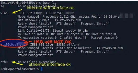

With Ubuntu 16.04 the USB wifi interface are now wlxXXXXXXXXXXXX where the X are the digits of the device's mac adress (policy of predictable interface name) More information about this can be find here: systemd:PredictableNetworkInterfaceNames
actually all interface naming has changed but I was able to go back to the old fashion way (ethX for ethernet interface, wlanX for inetrnal wifi card) modifying /etc/default/grub as suggested in the third post of this thread changing network interfaces name ubuntu 16-04 My problem is that this solution doesn't works for the USB interfaces and I still have this very annoying long name (i use command line a lot to play with my wifi interfaces) interface naming issue
 So here is my question:
What should I do to disable this new rules for my USB wifi interface? Thanks for your advices and excuse my poor english. Bye
