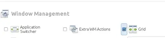

The grid plugin of compiz is responsible for window placement via Ctrl+Super+Arrow Right/Left. For whatever reason, you may not have it enabled.
Install Compiz Config Settings Manager with sudo apt-get install compizconfig-settings-manager and ensure that Grid is checked just like in the screenshot below
