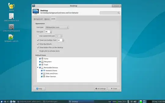

Here is a screenshot of my Display settings:
Notice that even though I have Home, Filesystem, Trash, and all Removable Devices selected to show up, none of them do. How do I make them show back up again like they used to?
Note: I use nemo as my default file manager; I don't know if that's related. All of this began when my computer went to sleep while it was connected to a network drive, and I woke it back up again. This caused it to freeze, so I logged off then back on, then was forced to restart. See my comment on that under this answer here: https://askubuntu.com/a/764120/327339. Upon restarting, and after many restarts and completely turning it off since then, my default desktop icons remain disappeared.
Also note that even the icons you see on my desktop above do NOT show up when I first boot. They only appear AFTER I open up my nemo file manager at least one time after booting.

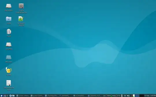

Once I did the above and my icons all came back, I changed my background back to the original one, as it was one of the fancy photos after doing the commands above. Here's what it looks like now:
