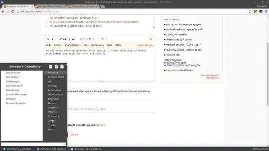

All of my icons have disappeared after an update; I tried selecting different icon themes but still no icons are showing up when I log in.
