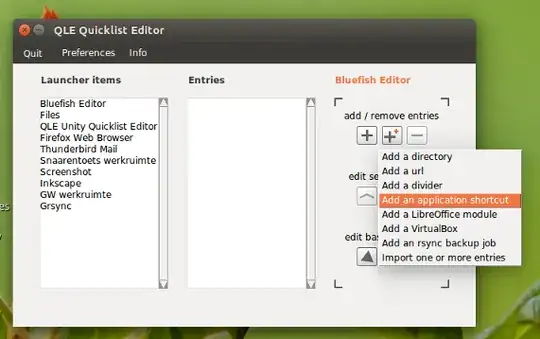

    Open the quicklist editor:
    Click on the big + icon, with the small + orange icon inside. In the popup list, choose "Add an application shortcut".

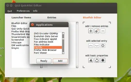

  3. In the listbox, select your application and press Add
  4. Done. Your applications was added to the icon:
Repeat this for every application you want to add to the icon.
