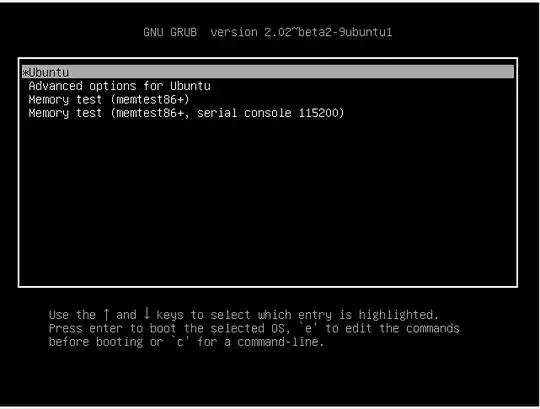

  1. While booting press (better hold down) the Shift key to bring the grub menu that looks like the following image:
    entering grub
    As you can see there are some options to choose from (this will vary from installation to insatllation), the one to look for is the third option in this screenshot i.e. Memory test (memtest86+), which will be there in the grub menu along with other options.
  2. From the grub menu go to the appropriate option to select i.e. Memory test (memtest86+) and press Enter.

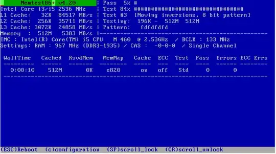

  3. Now you will see a blue screen indicating that the memtest is running:
    memtest running

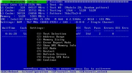

  4. Now you can press c for more configuration options:
    selecting conf options

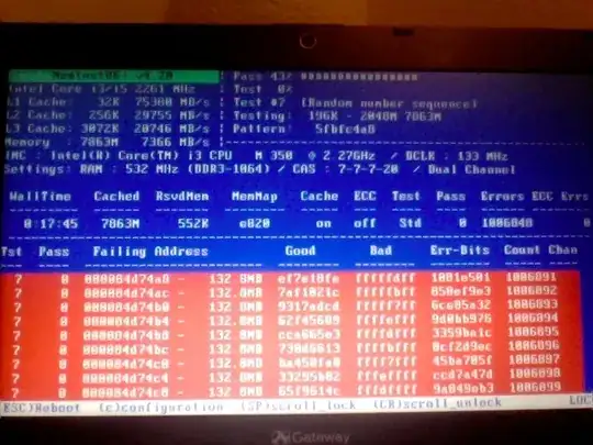

Here is an image (taken from here) showing that errors were encountered i.e. the test is failing in some memory locations (pointed out in the red portion) indicating the locations might have problems. If your memory does not have any problem then you won't get any red portion.
error message
