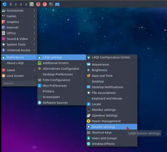

For Lubuntu 19.04+
Click on Menu > Preferences > LXQt settings > Session Settings

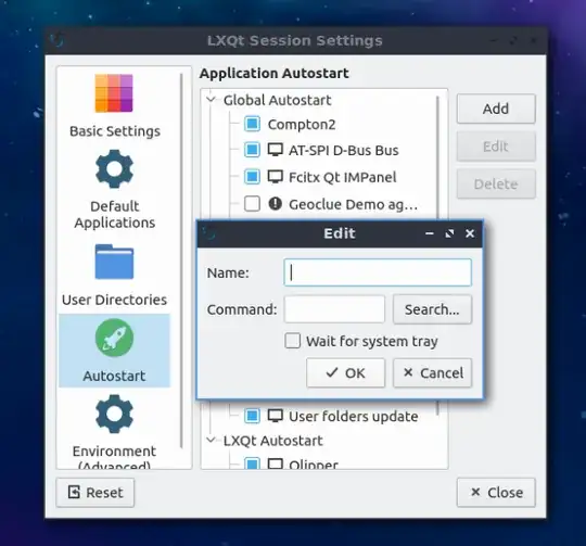

Click on Autostart in the left pane of the window that appears:
Add applications to Autostart
In here, you can type in the appropriate command or search for an application to be included and even remove items you don't wish to autostart.
