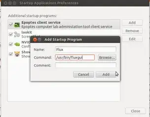

For ubuntu:
To add to startup from your dash search fpr startup applications
Enter your desired name
In the command browse to the : /usr/bin/fluxgui
save and that's it
