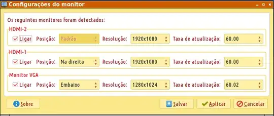

Here are my own experience, since I run Lubuntu and have three monitors.
sudo apt install arandr
After that, look in Lubuntu Menu:
  1. At Preferences menu, go to Monitor Settings
  2. Enable all monitors Lubuntu has detected (mark these checkbox at left) enter image description here
Open arandr (it's locates at Preferences sub-menu) and build your own scheme. Save your scheme at place you can find (i suggest ~/mx) and close arandr
When monitor scheme at sometime goes weird, just
  1. press CtrlAltT
  2. type bash ~/mx.sh
If you prefer, you can set this script to run at session login. Or customize a shortcut to make your work easier
