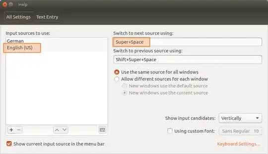

You can simply add English US (or any other layout without ALTGr) to your Text Entry settings.
Then, use the standard Super + Space to use Emacs with US keybindings. Unfortunately, you won't be able to use any local characters specific to your country.
Unfortunately, you can't just reconfigure ALTGr to ALT through emacs init. Altering your xkb map would be a solution but you didn't want that. This solution is more GUI-oriented. Enjoy.
