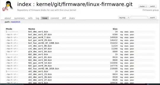

Match error message to driver needed
Compare the error message you are receiving by update-initramfs or update-grub to find the missing driver. In your example the message was "/lib/firmware/i915/kbl_guc_ver9_14.bin" so you are missing the Kabylake GuC called: kbl_guc_ver9_14.bin in the web page shown above. You don't want the newer one: kbl_guc_ver9_39.bin
Download driver needed

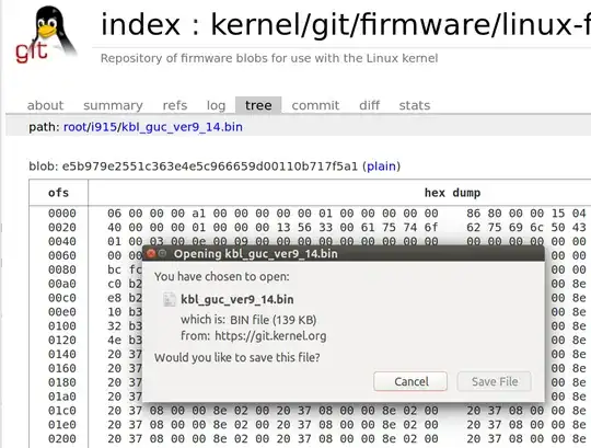

There is no more installation script as in past versions. Simply highlight the missing driver (blob) and click on it. This screen appears:
Initially you only see the "hex dump" but after clicking the link titled plain a download window appears as illustrated above.
Click "Save File"

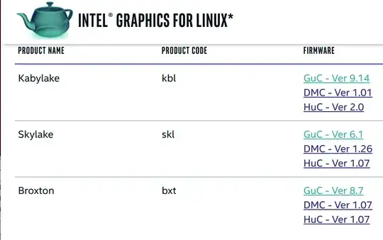

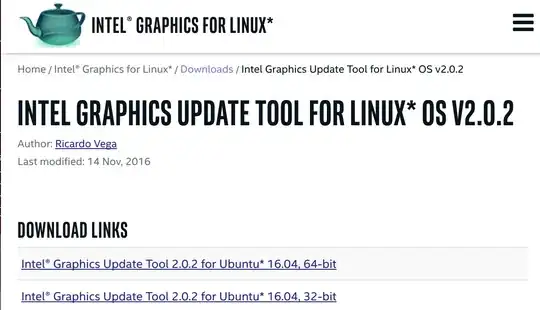

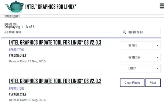

How to navigate Intel Graphics for Linux website
It was asked via comments how to navigate within the the new Intel website (01.org - Linux Graphics Downloads) which presents this screen:
Intel Graphics for Linux 1
Type Ubuntu 16.04 into the search field and click the Filter button.
For Ubuntu 16.10 select the first result. In our case Ubuntu 16.04 select the second result INTEL GRAPHICS UPDATE TOOL FOR LINUX* OS V2.0.2 and this screen appears:

In my case I selected Ubuntu 16.04 64-bit which downloaded the file intel-graphics-update-tool_2.0.2_amd64.deb to my ~/Downloads directory.
The next step is to open the terminal and use:
cd Downloads
sudo dpkg -i intel*.deb
NOTE: Intel uses the ancients ttf font and your installation will fail if it's not on your system. At this point you need to use:
sudo apt -f install
sudo apt update
sudo apt upgrade
Now you can run the Intel Graphics for Linux Updater tool as this screen shows:

If you are running debian (I have Debian GNU/Linux buster) just follow these steps:
  1. create the folder:
    sudo mkdir -p /lib/firmware/i915
  2. copy all files from https://git.kernel.org/pub/scm/linux/kernel/git/firmware/linux-firmware.git/plain/i915 to this folder
  3. Reconfigure the initramfs-tools package:
    sudo dpkg-reconfigure initramfs-tools
The firmware-blob-variant with sudo cp is dirty, this is not a clean installation.
As clean installation like this:
Download the newest linux-firmware from here and install the saved package via terminal with apt:
$ cd Downloads
$ sudo apt install ./linux-firmware_1.190_all.deb
