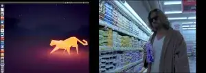

When I watch a movie with VLC and want to watch on full-screen on my 22" screen (the right one), I move my VLC window in right screen and then click on full-screen => no problem.

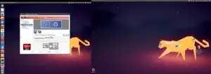

BUT when using Firefox and watching streaming video, watching on full-screen is always on 17" screen (left one).
full-screen with firefox

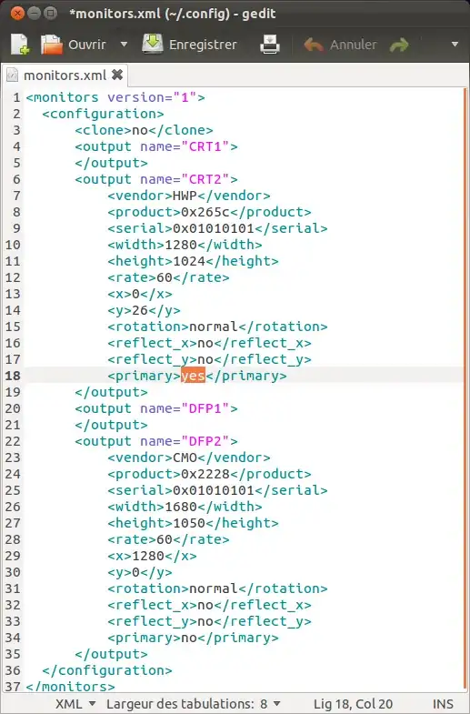

After reading severals questions about the subject "multiple-monitors", I've found the solution.
In this answer I've discovered the existance of file ~/.config/monitors.xml. (thank you "pamar84")
So I did this:
  1. do a backup of this file cp ~/.config/monitors.xml ~/.config/monitors.xml-bkp
  2. open this file gedit ~/.config/monitors.xml
  3. this file was containing 3 configurations !!!
    So I did some cleaning:
    • I've found the configuration that I'm using and remove the 2 others.
    • also set my left screen to be the primary one.
Now with such nice ~/.config/monitors.xml file, Firefox is not disoriented anymore and have the good behavior:
- when my window is left side and I choose full-screen => full-screen is left screen
- when my window is right side and I choose full-screen => full-screen is right screen
Here is the content of the cleaned ~/.config/monitors.xml file: enter image description here
