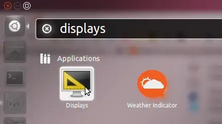

Usually you switch the default display in Ubuntu's own display manager. It goes like this:
Dash display settings

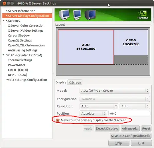

However, depending on your GPU driver you might need to use another application than the display manager instead. Since I have an nVidia Graphics card for instance, the display manager won't work for me. I have to use the NVIDIA X Server Settings manager, shown in the picture below:
Nvida Display Manager
