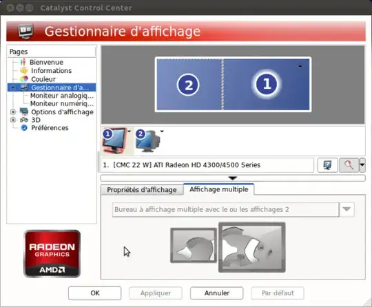

You need to define your 2 screens in AMD soft.
  1. Open ATI driver application
  2. and define your 2 screens display without any limit.
    amd settings
  3. and re-boot

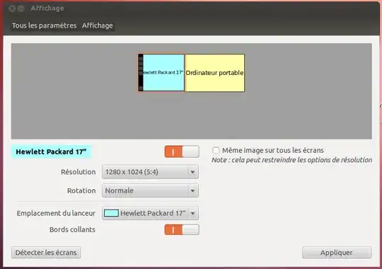

  4. you might see no changes, but to end the manipulaation, use then the normal Screen application to set your 2 screens.
    And for new Ubuntu behaviors too like:
    • unity toolbar on only screen, or on both (in english it's got to be "launcher position")
    • mouse stuck on screen border (in english it's got to be "sticky border")

Solution 1. Disable proprietary driver. Reboot. Now go to Settings > Displays and uncheck the "mirror displays" box. You may also wish to alter the "launcher placement" setting so that you have one launcher on one monitor, not an additional one on the 2nd monitor. You may also wish to disable "sticky edges" so that your mouse won't catch when moving between the two monitors.
Solution 2. This is a clarification of Boris's answer who recommends using the AMD/ATI control panel, but his image was in French and there are more details needed. If you're really set on running the proprietary driver, open AMD Catalyst Control Center (I use the Administrative version, not sure if that's required or not). Then you'll need to set the two monitors to have nothing to do with each other... not mirroring, and not multi-desktop. Just single. Then reboot. THEN in the next page down in Catalyst Control Center's option pages, enable Xinerama, and reboot again.
In some cases the latter solution doesn't work. For example in my current situation, something wasn't allowing me to dissociate the two monitors... they kept getting forced into cloning. I was allowed to change the setting, but as soon as I closed the application the setting was lost.
