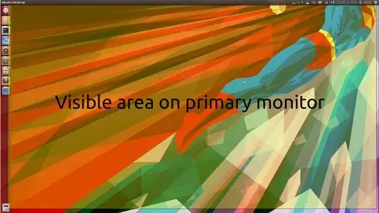

I I have a dual-screen setup with my laptop (1366x768) and an external monitor connected through HDMI (primary 1920x1080).
I don't know if this is cause by different aspect ratios (16:10 on laptop, 16:9 on external monitor) but Unity appears cropped approximately as shown in this picture:
If I use a lower resolution (1680x1050, 16:10) the desktop is correctly displayed, but those extra pixels could be handy.
So is this any limitation/bug on Unity? How can I make it display the desktop correctly at 1920x1080 pixels?

See HDMI/VGA connection cuts borders of screen or creates blurry text (and also Edges of screen cut off in Ubuntu 12.04):
NOTE (Comment made by User James - https://askubuntu.com/users/39762/james): For some Samsung LCD TVs. Using the TV Remote Control go to Options -> Picture Options and set the Picture Option to "Fit to Screen".
Hope this helps.
