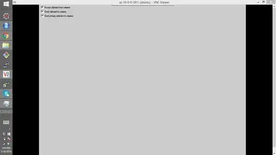

Greeting. I am on ubuntu 16.04 LTS. It is an amazon EC2 instance I got grey screen upon installing and starting the vncserver I try many suggestion regarding this issue but still cant get it work.... Thanks for the help

I had the same issue on Ubuntu 16.04 LTS (64bit). I updated ~/.vnc/xstartup file to look like below, worked successfully for me.
# Uncomment the following two lines for normal desktop:
# unset SESSION_MANAGER
# exec /etc/X11/xinit/xinitrc
[ -x /etc/vnc/xstartup ] && exec /etc/vnc/xstartup
[ -r $HOME/.Xresources ] && xrdb $HOME/.Xresources
xsetroot -solid grey
vncconfig -iconic &
x-terminal-emulator -geometry 80x24+10+10 -ls -title "$VNCDESKTOP Desktop" &
x-window-manager &
gnome-panel &
gnome-settings-daemon &
metacity &
nautilus &
Reference: https://www.linode.com/docs/applications/remote-desktop/install-vnc-on-ubuntu-16-04

29
I had the same issue. To resolve it, I installed:
$ sudo apt-get install gnome-panel gnome-settings-daemon metacity nautilus gnome-terminal
Then I added the lines below to ~/.vnc/xstartup:
gnome-panel &
metacity &
nautilus &

10
Not mentioned in any of the answers at the time of writing: it is also worth noting that the xstartup file needs to be executable:
chmod +x ~/.vnc/xstartup
If not, the grey screen issue continues to occur regardless of the contents of the file.

All answers are partial. Hence, I'm writing this answer to help someone.
Step 1: Install Gnome Panel
Step 2: The xstartup file needs to be executable
Step 3: Update the ~/.vnc/xstartup file
Take your favorite editor and edit this file. Mine is vim. So I run the following command. vim ~/.vnc/xstartup.
Add the following lines to the file.
gnome-panel &
metacity &
nautilus &
Step 4: Restart VNC Server
Kill the vncserver.
vncserver -kill :1
Start the vncserver.
vncserver :1
Step 5: Check whether it is working
Run nc IP PORT.
Example: nc 104.197.91.140 5901
Sometimes, it is not brought by the xstartup file. The default one might be ok. Just try to use another port number (:2, :3, etc.). Works for me:)
