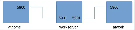

I was able to simulate (I hope) your situation, if I understood it.
The need is to connect to a machine atwork's VNC server. atwork is not accessible via ssh from the client machine athome. However, atwork is accessible via ssh from the intermediate machine workserver. workserver is accessible via ssh from athome.
If this is the correct scenario, I was able to connect in a similar situation. I used remmina which by default tries to connect on port 5900. Here is how I did it using intermediate port 5901. Adjust ports as necessary in your situation.
  • Set up first tunnel from athome to workserver.
    ssh -L 5900:localhost:5901 -N -f -l username workserver
  • Set up 2nd tunnel from workserver to atwork
    SSH into workserver and enter the next command. Leave this ssh window open.
    ssh -L 5901:localhost:5900 -N -f -l username atwork
  • Back on athome, start remmina and connect to localhost
Somewhat to my surprise, it worked.
When done, go back into the workserver ssh window and killall ssh. Then killall ssh on athome.
