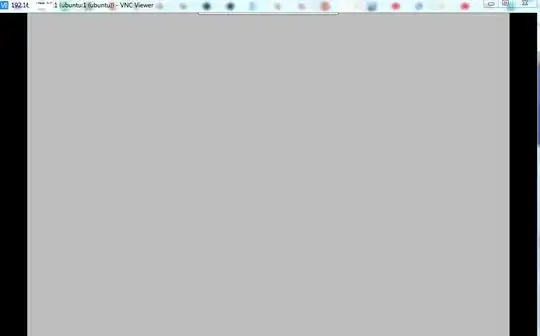

When I try to view a ubuntu machine via VNC, I get a grey screen with 3 checkboxes . I have tried some suggestions I read online but one doesn't help. One still gives me the grey screen with 3 checkboxes, one gives me the grey screen without the three checkboxes, and one gives me a grid! That's following various suggestions on how to amend vnc's xstartup file. Further elaboration below.

I get a grey screen with 3 checkboxes.
Here see I start the vnc server (and I include some other commands I used, to list processes, as any time i'd change xstartup i'd see if the server was running, and kill it and start it again). And I checked that it is running and on what port, port 5901. And that it's not blocked by the firewall ubuntu uses by default.. ufw, I see from ufw status that the ufw firewall is not enabled so no issue there. vnc server has started.

I also run the ip add command to see my IP.
I then go to my other machine which runs windows and I enter the IP:5901 and enter the correct password and the password was accepted.
and I get this grey screen with three checkboxes "accept clipboard from viewers", "send clipboard to viewers", "send primary selection to viewers"
I make amendments based on the first link vnc-grey-screen (172384),but get same grey screen same three checkboxes, that's with

and i get a grey screen though this time with no checkboxes

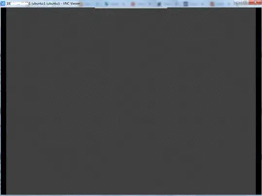

doing that (and of course killing and starting the vnc server) $killall Xvnc4<ENTER> and $vnc4server<ENTER>
I get this screen when trying to connect, it's like a grid
Added
