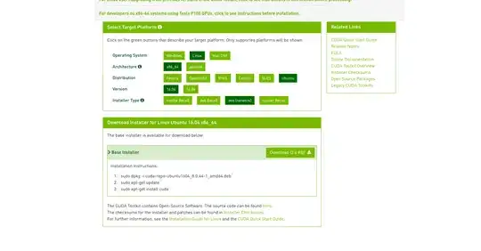

NVIDIA CUDA Installation Guide for Linux is an excellent link that lists the complete details.Make sure you follow each step as it is given .

You can easily install CUDA according to the previous link now. In brief:
sudo apt-get install linux-headers-$(uname -r)
Download a toolkit from here and then install the .deb file (replace name accordingly)
sudo dpkg -i cuda-repo-<distro>_<version>_<architecture>.deb
then run:
sudo apt-get update
sudo apt-get install cuda

  • (my opinion) Use the Linux .deb (package manager) installation (for simplicity.). Download the .deb file in a browser. Install from terminal command line.
  • (my opinion) Don't use runfile installation (too complicated).

The steps that worked for me:
  1. sudo apt-get install nvidia-cuda-toolkit OR 1'. the installation instructions here
  2. You need to select from Software&Updates/Additional Drivers the nvidia driver (375, in my context)
  3. Follow the blue screen when you restart and only from there disable secure boot by inputting your password set during nvidia driver install. (any secure boot disabling through the BIOS did not work for me).
Now the installation test output is successful.
A generally preferred method is to install SW is via deb files when available as they provide a more robust way to handle dependencies and a more reliable method for removing SW. The CUDA 8.0 release-candidate was available for 16.04 (in the dev zone) that way and now the CUDA 8.0 for Ubuntu 16.04 is available via deb files (local) and (network) :https://developer.nvidia.com/cuda-downloads
