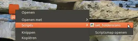

2. More advanced
...is to make it a right-click option in nautilus:
The script is slightly different then:
#!/usr/bin/env python3
import subprocess
import os
# --- set the list of valid extensions below (lowercase)
# --- use quotes, *don't* include the dot!
ext = ["jpg", "jpeg", "png", "gif", "icns", "ico"]
# retrieve the path of the targeted folder
current = os.getenv("NAUTILUS_SCRIPT_CURRENT_URI").replace("file://", "").replace("%20", " ")
dr = os.path.realpath(current)
for root, dirs, files in os.walk(dr):
    for directory in dirs:
        folder = os.path.join(root, directory)
        try:
            first = min(p for p in os.listdir(folder)
                        if p.split(".")[-1].lower() in ext)
        except ValueError:
            pass
        else:
              subprocess.Popen([
                  "gvfs-set-attribute", "-t", "string",
                  os.path.abspath(folder), "metadata::custom-icon",
                  "file://"+os.path.abspath(os.path.join(folder, first))
Download from Pastebin
To use
  1. Create, if it doesn't exist yet, the directory
    ~/.local/share/nautilus/scripts
  2. Copy the script into an empty file, save it in ~/.local/share/nautilus/scripts as set_foldericons (no extension!), and make it executable.
  3. Log out and back in, it works.
