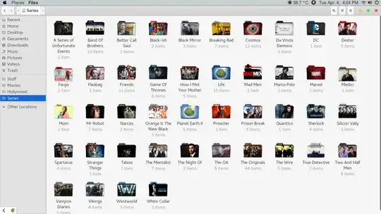

How can I change the icons of many folders?
How to set the first picture of every folders as their folder icons?

This script was written by Jacob Vlijm and was originally posted here.
#!/usr/bin/env python3
import subprocess
import os
# --- set the list of valid extensions below (lowercase)
# --- use quotes, *don't* include the dot!
ext = ["jpg", "jpeg", "png", "gif", "icns", "ico"]
# retrieve the path of the targeted folder
current = os.getenv("NAUTILUS_SCRIPT_CURRENT_URI").replace("file://", "").replace("%20", " ")
dr = os.path.realpath(current)
for root, dirs, files in os.walk(dr):
    for directory in dirs:
        folder = os.path.join(root, directory)
        try:
            first = min(p for p in os.listdir(folder)
                        if p.split(".")[-1].lower() in ext)
        except ValueError:
            pass
        else:
              subprocess.Popen([
                  "gvfs-set-attribute", "-t", "string",
                  os.path.abspath(folder), "metadata::custom-icon",
                  "file://"+os.path.abspath(os.path.join(folder, first))
To use
  1. Create, if it doesn't exist yet, the directory
    ~/.local/share/nautilus/scripts
  2. Copy the script into an empty file, save it in ~/.local/share/nautilus/scripts as set_foldericons (no extension!), right click and go to file properties and make it executable.
  3. Log out and back in, it works.
If you want to hide all the folder icons (so that you don't accidentally presume they are folders) add a . at the start of file names, for example folder.png becomes .folder.png
all set, with one script
Original work
