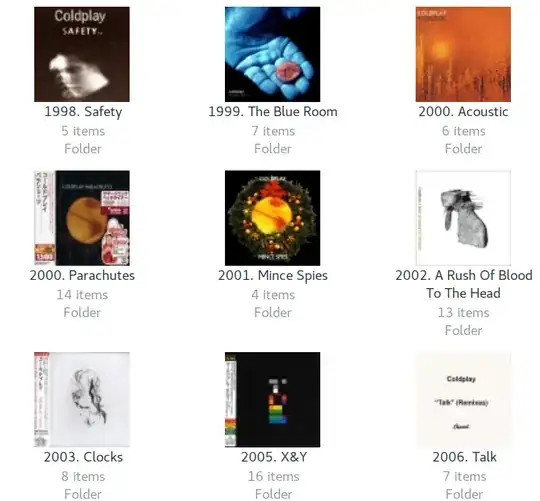

  • Your albums should have cover arts now
Screenshot of albums with cover pics
