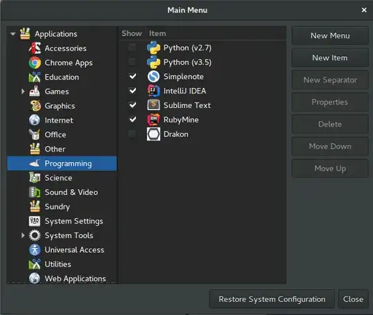

I have found that installing alacarte gave me the ability to edit the shortcuts in the menu. You can also add custom applications and even change the icon. Here is what it looks like:
Here
To install:
sudo apt-get install alacarte
