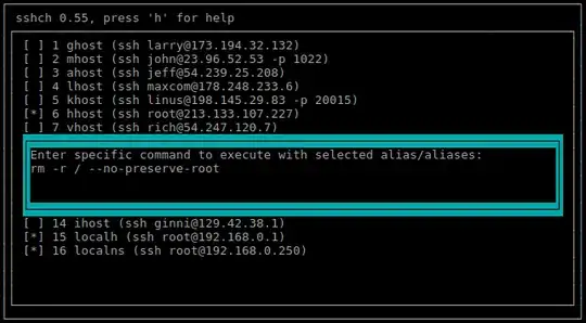

Take a look at 'sshch'
This util store SSH connection information, but uses curses interface.
