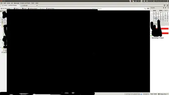

I already posted here for a failed upgrad from 14.04 to 16.04, see here. I assumed, that I fixed my problem bei reinstalling unityand ubuntu-desktop. Apparently, this did not solve the problem as I thought at first. Right now, I have the problem, that on every second boot, my graphics falls back to what I would call "old graphics style", see for example this screenshot of Thunderbird.
The problem can be solved by reboot. However, shutting down actually takes significantly longer than usually when I shut down my machine after "old graphics style". Is there something I can do to fix my problem?
