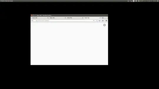

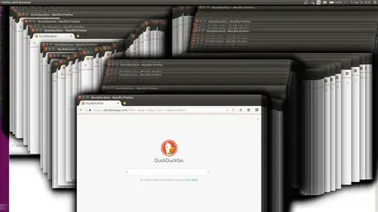

and started the upgrade. However, after having downloaded all files and running the installation, the upgrade failed, or at least it failed partially. There is some erroneous behavior regarding graphics and window management. The two screenshots show the behavior, something similar to what we know from Windows...

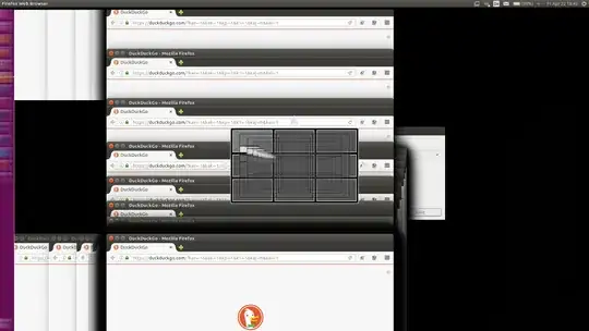

After restarting multiple times, I notice that from time to time the applications also look differently, see the following screenshot. enter image description here

I think I fixed the error.
I reinstalled unity and ubuntu-desktop. I also had to enable desktop icons again (Ubuntu Tweak -> Tweaks -> Desktop Icons -> On). Everything looks normal again.
