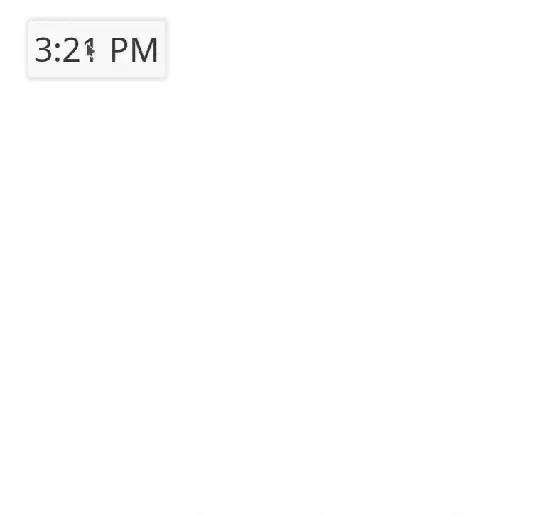

Short statement of the problem: short-format date shows as 6/5/16 on my desktop under the clock. I want it to say 2016-06-05. (Or maybe something else.) I'd like to find the place I tell it "Use %H-%m-%d there." This used to be doable, but I think the feature was removed somewhere along the line.

KDE Plasma 5 digital clock settings
From the Hour:Minute AM/PM to 24 hour clock with the ISO date.
Right click the clock widget, pick the 'Digital Clock Settings'
Appearance:
  • Use 24-hour Clock
  • Show date
  • Date format: ISO Date
