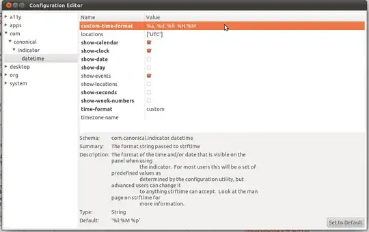

GUI method
You can also set those keys using a GUI called dconf-editor. It's part of the package dconf-tools, which you'd need to install first by running sudo apt-get install dconf-tools. Then open dconf-editor, navigate to com.canonical.indicator.datetime, and set the two keys.
screenshot of <code>dconf-editor</code> at <code>com.canonical.indicator.datetime</code> schema
