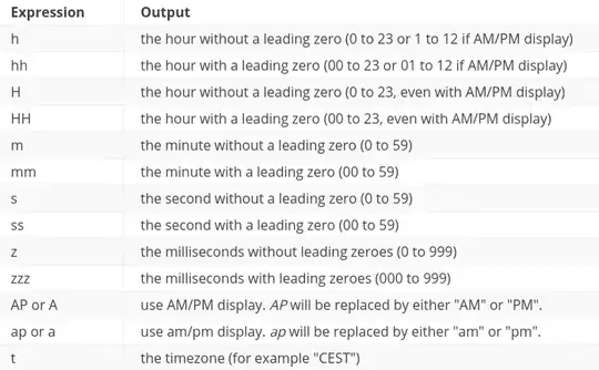

The Date QML Type: http://doc.qt.io/qt-5/qml-qtqml-date.html
-> Date: enter image description here
-> Time: enter image description here

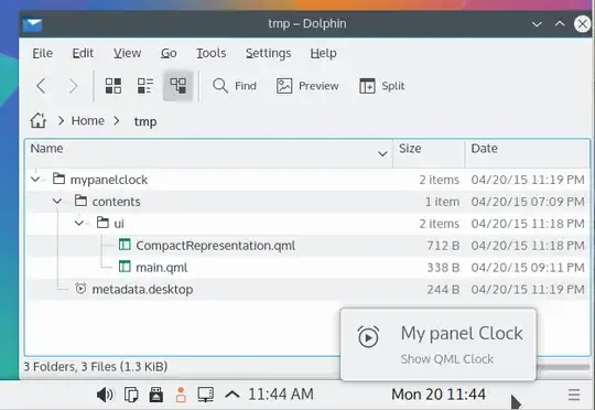

My panel clock
Writing a quick and dirty clock.
Making:
Opening a terminal window to the tmp directory and running command:
plasmapkg2 -i mypanelclock
The command:

Now there are available:
Adding the clock to the panel:
