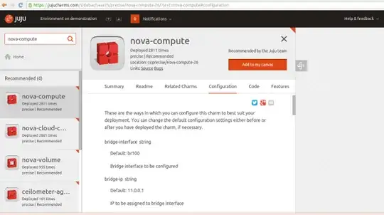

Other settings and configuration options are possible for deployment of the OpenStack services. These are detailed in the documentation of the individual charms used by Juju, and can be inspected by visiting the online Juju Charm Store and searching for the charm using the search box in the top left-hand-side of the page. the configuration settings are then detailed under "Configuration" in the main page, as shown:
