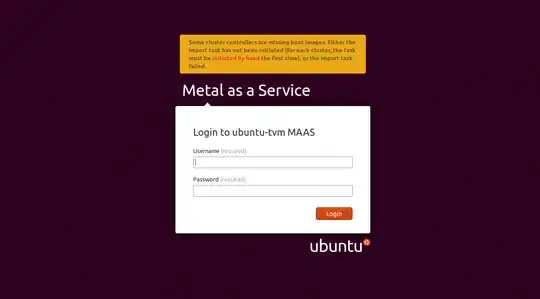

Import the boot images
MAAS will check for and download new Ubuntu images once a week. However, you'll need to download them manually the first time. To do this you should connect to the MAAS web interface using a web browser. Use the URL:
http://172.18.100.1/MAAS/
You should substitute in the IP address of the server where you have installed the MAAS software. If there are several possible networks, by default it will be on whichever one is assigned to the eth0 device.
You should see a login screen like this:
Enter the username and password you specified for the admin account. When you have successfully logged in you should see the main MAAS page:
Either click on the link displayed in the warning at the top, or on the 'Cluster' tab in the menu to get to the cluster configuration screen. The initial cluster is automatically added to MAAS when you install it, but it has no associated images for booting nodes with yet. Click on the button to begin the download of suitable boot images.
Importing the boot images can take some time, depending on the available network connection. This page does not dynamically refresh, so you can refresh it manually to determine when the boot images have been imported.

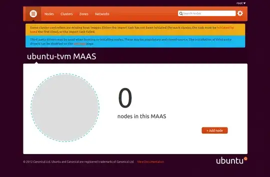

Login to the server
To check that everything is working properly, you should try and login to the server now. Both the error messages should have gone (it can take a few minutes for the boot image files to register) and you can see that there are currently 0 nodes attached to this controller.

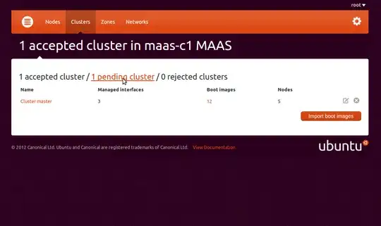

Cluster acceptance
When you install your first cluster controller on the same system as the region controller, it will be automatically accepted by default (but not yet configured, see below). Any other cluster controllers you set up will show up in the user interface as “pending,” until you manually accept them into the MAAS.
To accept a cluster controller, click on the "Clusters" tab at the top of the MAAS web interface:
You should see that the text at the top of the page indicates a pending cluster. Click on that text to get to the Cluster acceptance screen.
Here you can change the cluster’s name as it appears in the UI, its DNS zone, and its status. Accepting the cluster changes its status from “pending” to “accepted.”

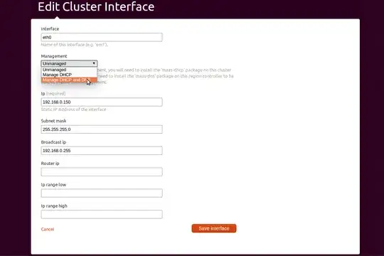

MAAS automatically recognises the network interfaces on each cluster controller. Some of these will be connected to networks where you want to manage nodes. We recommend letting your cluster controller act as a DHCP server for these networks, by configuring those interfaces in the MAAS user interface.
As an example, we will configure the cluster controller to manage a network on interface eth0. Click on the edit icon for eth0, which takes us to this page:
Here you can select to what extent you want the cluster controller to manage the network:
  • DHCP only - this will run a DHCP server on your cluster
  • DHCP and DNS - this will run a DHCP server on the cluster and configure the DNS server included with the region controller so that it can be used to look up hosts on this network by name (recommended).
You cannot have DNS management without DHCP management because MAAS relies on its own DHCP server’s leases file to work out the IP address of nodes in the cluster. If you set the interface to be managed, you now need to provide all of the usual DHCP details in the input fields below. Once done, click “Save interface”. The cluster controller will now be able to boot nodes on this network.
There is also an option to leave the network unmanaged. Use this for networks where you don’t want to manage any nodes. Or, if you do want to manage nodes but want to use an existing DHCP service on your network.

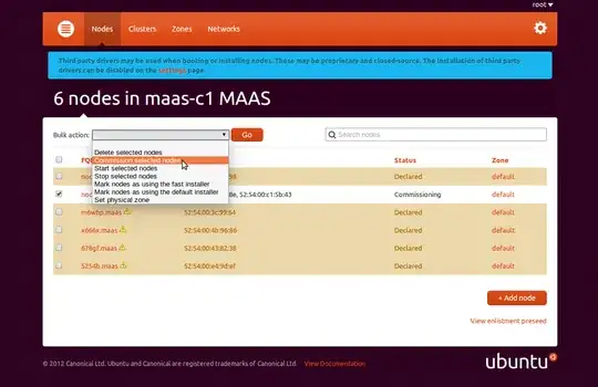

Automatic Discovery
With nodes set to boot from a PXE image, they will start, look for a DHCP server, receive the PXE boot details, boot the image, contact the MAAS server and shut down.
During this process, the MAAS server will be passed information about the node, including the architecture, MAC address and other details which will be stored in the database of nodes. You can accept and comission the nodes via the web interface. When the nodes have been accepted the selected series of Ubuntu will be installed.
You may also accept and commission all nodes from the commandline. This requires that you first login with the API key, then run the command:
maas-cli maas-profile nodes accept-all

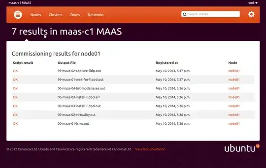

Once commissioned, the node's status will be updated to "Ready". you can check the results of the comissioning scripts by clicking on the node name and then clicking on the link below the heading "Commissioning output". The screen will show a list of files and their result - you can further examine the output by clicking on the status of any of the files.

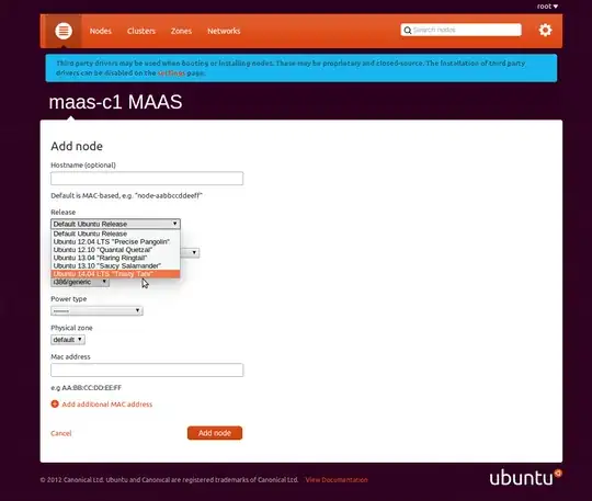

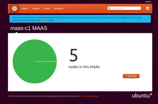

Manually adding nodes
If your nodes are not capable of booting from PXE images, they can be manually registered with MAAS. On the main web interface screen, click on the "Add Node" button:
This will load a new page where you can manually enter details about the node, including its MAC address. This is used to identify the node when it contacts the DHCP server.

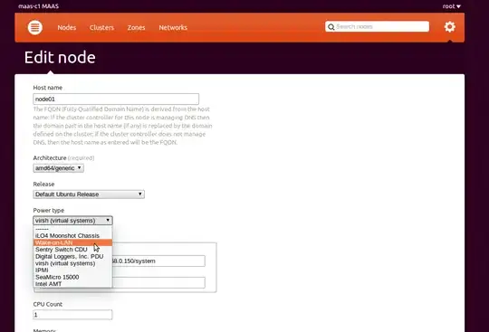

Power management
MAAS supports several types of power management. To configure power management, you should click on an individual node entry, then click on the "Edit" button. The power management type should be selected from the drop down list, and the appropriate power management details added.
If you have a large number of nodes, it should be possible to script this process using the MAAS cli.
Without power management, MAAS will be unable to power on nodes when they are required.
