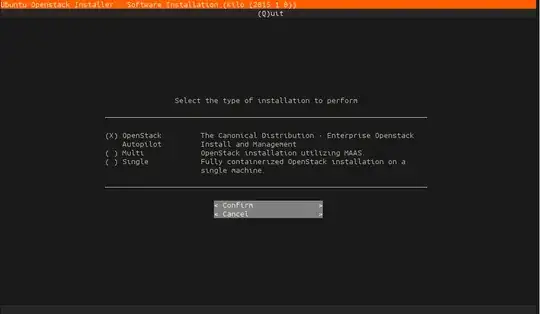

Install selection
Third
You're presented with 3 options, a Single Install, Multi Install, and Landscape. Select Single Install.

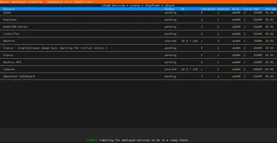

The installer will go through its little routine of installing necessary packages and setting up configuration. Once this is complete you'll be dropped into a status screen which will then begin the magical journey of getting you setup with a fully functioning OpenStack cloud.
Yep, to elaborate a bit I'll explain what's happening:
The entire stack is running off a single machine. Juju is heavily utilized for its ability to deploy services, setup relations, and configure those services. Similar to what juju-deployer does. What juju-deployer doesn't do is automatically sync boot images via simplestreams or automatically configure neutron to have all deployed instances within nova-compute available on the same network as the host machine all while using a single network card. We even throw in juju-gui for good measure!
The experience we are trying to achieve is that any one person can sit down at a machine and have a complete end to end working OpenStack environment. Here's a screenshot of the nifty console ui:

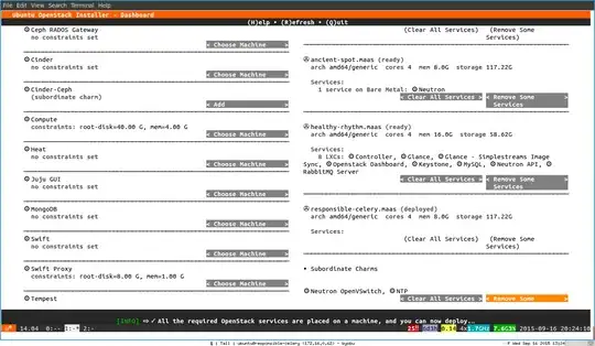

If you need swift storage for your glance images hit (F6) in the status screen and select Swift storage. This will deploy the necessary bits for swift-storage to be integrated into your Openstack cloud. Swift storage requires at least 3 nodes (in the single install this would be 3 VMs) so make sure you've got the hardware for this. Otherwise, for developing/toying around with Openstack leaving the defaults works just as good.
Add swift storage
Want to deploy additional instances on your compute nodes? Add additional machines to your MAAS environment or if running on a single machine and you have the hardware add a few more nova-compute nodes (via F6 in the status screen) to allow for more instances to be deployed within Openstack.
