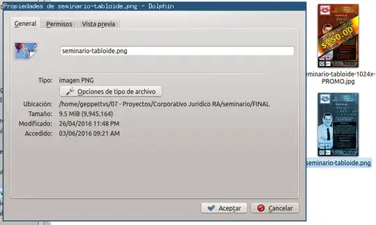

High Definition Pictures, with resolutions over 1024px may have a big file size. I provide an example on this screenshot:
In the file properties window we can see this is a 9.5 MB file, which will delay a lot to upload and will delay a lot in order to render on screen when published in a website.

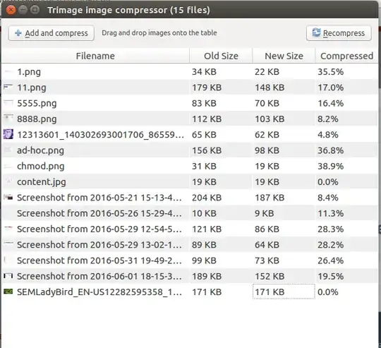

I use Trimage super simple to use.
only add picture and it compress to install :
sudo apt-get install trimage

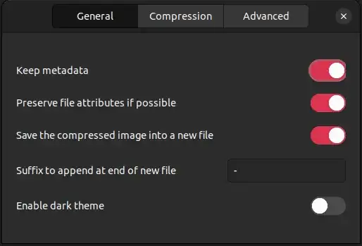

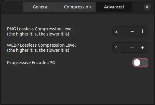

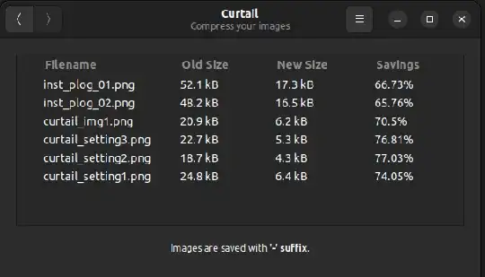

screenshots
main
Settings
setting1
setting2
setting3
