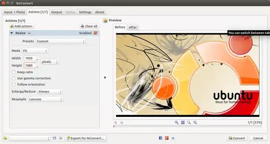

There is a good multiplatform tool called XnConvert. Combine and choose between more than 80 different operations. The installation is simple through deb. file from the official website.
It is free but not opensource, perhaps that's just the beauty of it.
