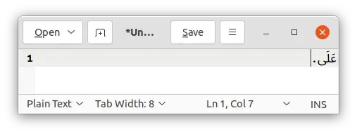

Here is an example of four properties being met in Gedit:
Gedit screenshot

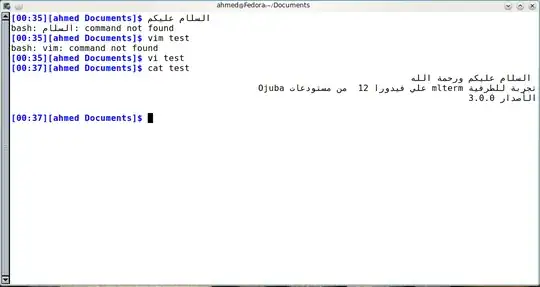

Use Mlterm, It's has great support for Arabic and other non-latin characters. You can download it from Ubuntu repositories:
sudo apt install mlterm
Picture of Mlterm showing Arabic

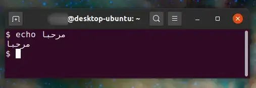

GNOME Terminal 3.34 supports right to left scripts such as Arabic.
The work actually went into VTE version 0.58, so any other terminal emulator using VTE (e.g. Tilix, Terminator, Xfce Terminal, Guake...) will automatically receive it.
It's going to debut in Ubuntu 19.10 Eoan Ermine.
Screenshot

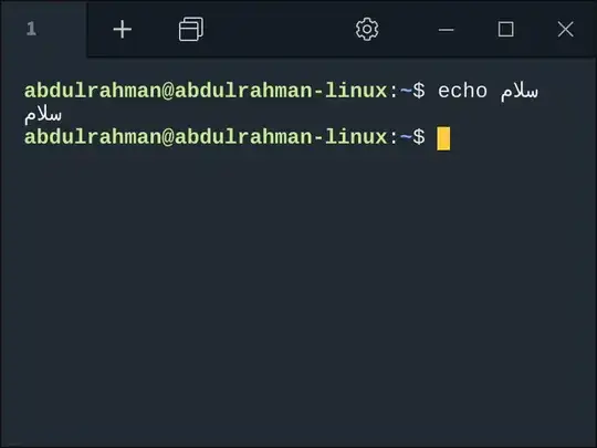

  1. use tabby (an electron app - web based):

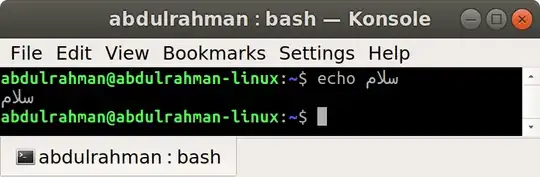

  1. use Konsole (the default emulator for KDE distros):
    sudo apt install konsole

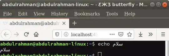

  1. use butterfly (a pure web based terminal):
thank you @singrium
