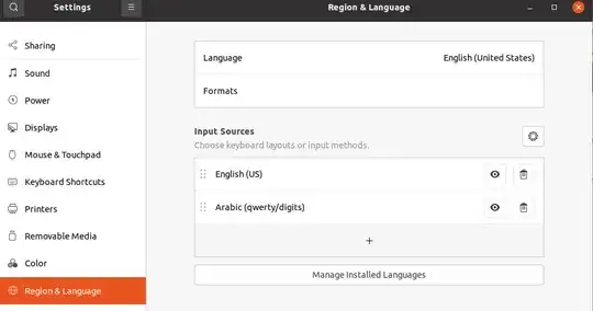

  1. Go to setting
  2. Choose region & language
  3. In input sources click the +
  4. Choose from Arabic(Jordan) Arabic(qwerty/digits)
  5. Remove the old Arabic language from garbage icon that in its raw
That's all. Problem should be fixed system wide now. This idea I take it from this answer
this is the final setting screenshot
i-o55

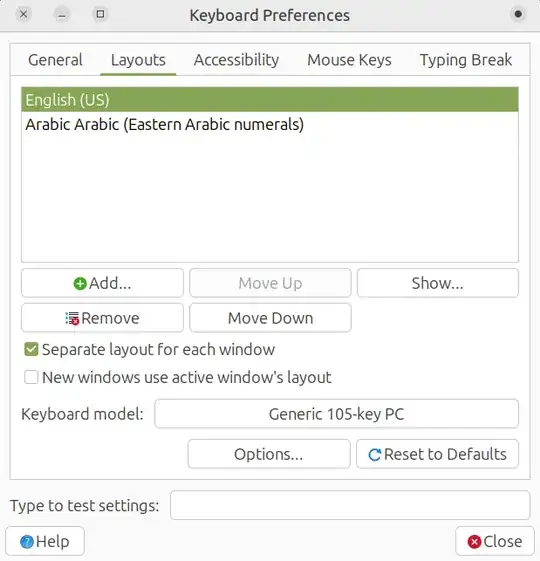

Instead of using the generic Arabic keyboard layout use one that has Eastern Arabic numerals in it.
For example, I use MATE desktop environment so I would:
  • invoke keyboard preferences either by using the command mate-keyboard-properties or choose Keyboard from the Control Center then
  • choose the Layouts tab, you'll get the screenshot below then
  • press the Add button and add the Arabic Arabic (Eastern Arabic numerals) keyboard layout
Keyboard Layouts
