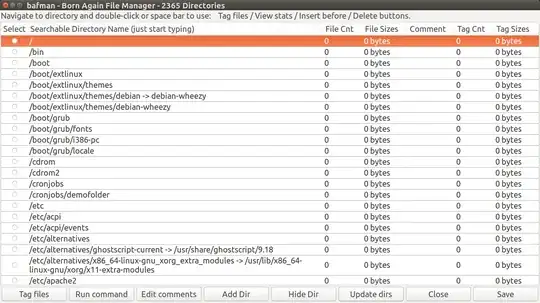

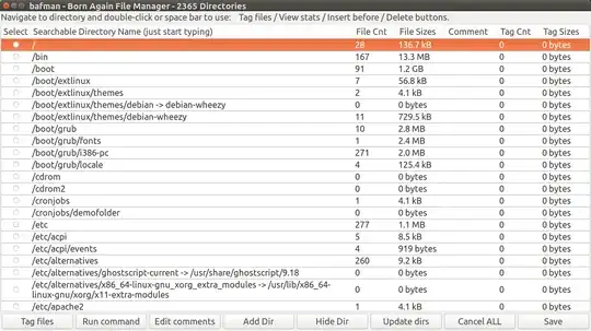

When you invoke bafman for the first time this screen appears after a few moments:
bafman 1
This is the main screen. You can click on any column heading to sort in ascending then descending order. You can grab the column divider and move it to adjust column width.

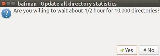

When you click on the Update Dirs button you are greeted with this initial warning:
bafman 2
10,000 directories is an extraordinary situation if for example you add the /usr directory and /var directory to bafman list. In our example we have 2,365 directories and it takes about 5 minutes to scan all files in them.

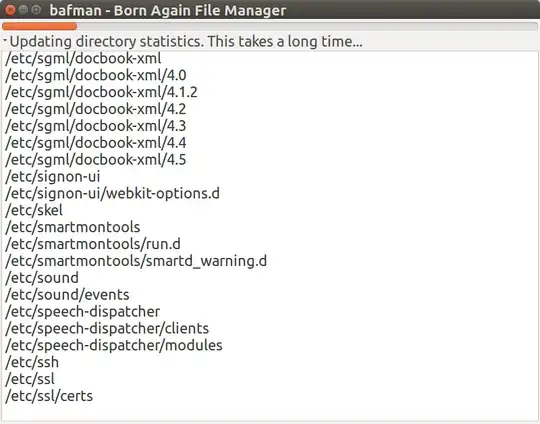

While scanning all files in all directories this progress screen appears:
bafman 3
When all is said and done the main screen is updated like this:
bafman 4
Once again it's important to note you can click on "File Sizes" column to sort on ascending order (smallest on top) and click again for descending order (directories with largest file sizes on top).
Search on directory name is possible by simply typing the directory you want to advance to. For example type /etc/default and the screen scrolls to that directory.

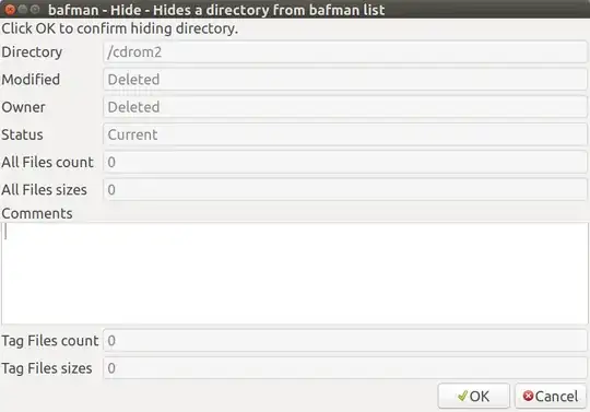

I noticed I have a directory called /cdrom2 which I forgot I created during testing the "fake" directory /cdrom (which you MUST KEEP). So let's remove /cdrom2 from the bafman list by clicking the Hide Dir button:
bafman 5
The directory /cdrom2 has already been removed from the drive so the Modified and Owner fields display as Deleted. These and other fields on this screen are described under the Edit comments section.
For the time-being select the OK button to hide the sub-directory and then this screen then appears:
bafman 6
It is possible to hide a directory and keep all the sub-directories under it on the bafman list. Then those individual sub-directories can be hidden or kept individually.

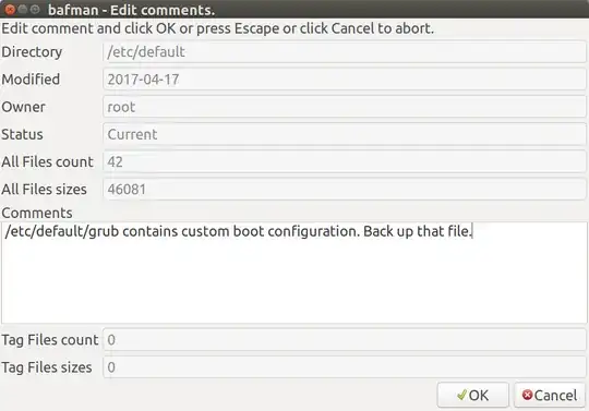

Edit comments button - enter comments for any directory.
When working with Linux / Ubuntu directories you have to remember lots of details about them so you can enter some important comments here.
From the main screen type /etc/default and the screen scrolls to that directory. Double click on it or hit the Space Bar to the select the directory and then click the Edit comments button:
bafman 7
Appropriate comments have been entered. Note that if you Hide the directory in the future the comments will be lost. The other fields on the screen are auto-generated every time you click the Enter comments button and will be saved on the main screen.

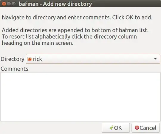

When you click the Add Dir button this screen appears with your home directory selected as default:
bafman 8
As you probably suspected already my real name isn't WinEunuchs2Unix as this screenshot reveals.
  • Click the directory drop down arrow
  • Select Other... from the list
  • Start typing /lib/systemd/
  • Click Open

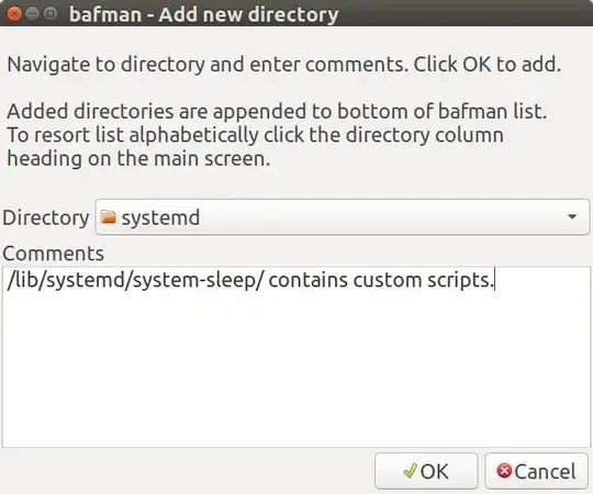

After selecting the directory to add, the screen reappears and we've typed in an appropriate comment:
bafman 9

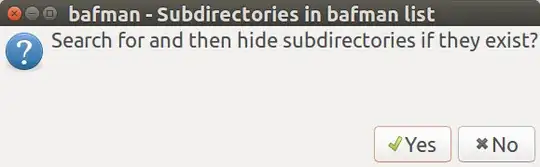

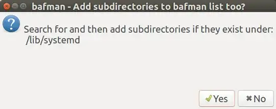

Click OK to add the directory and then you are prompted to add sub-directories under it:
bafman 10
For our example, click Yes.

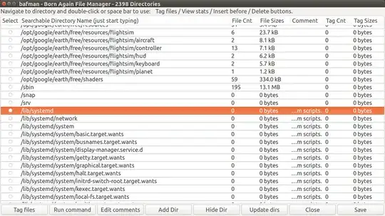

After adding the new directory and sub-directories under it the main screen reappears. Start typing /lib/systemd and the screen scrolls down to this section:
bafman 11
Here's an important note: When adding a new directory it is appended to the bottom of bafman's list. Simply click the Directory Name column heading to resort the list alphabetically.
All the statistics of file counts and file sizes are zero. If it were only a single directory we could simply click Edit comments button and those stats are generated for us. But it is easier to click Update Dirs button and go grab a coffee.
