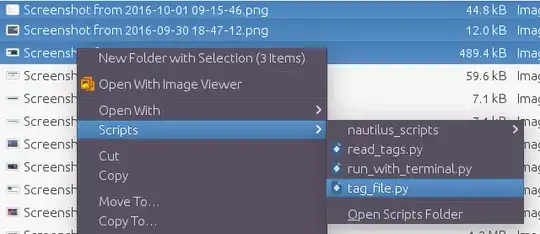

Select files in Nautilus file manager, right click on them, and navigate to Scripts submenu. Select tag_file.py. Hit Enter enter image description here First time you run this script, there will be no configuration file, so you will see this:

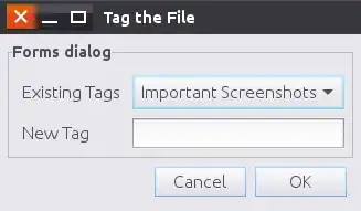

Next time, when you already have some files tagged, you will see a popup that allows you to select a tag and/or add new one ( this way you can record files under multiple tags). Hit OK to add files to this tag. Note:Avoid having "|" symbol in the tag name.

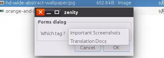

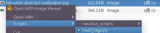

Right click on any file in Nautilus ( really doesn't matter which ).Select read_tags.py. Hit Enter enter image description here
You will see a popup asking you what tag you want to search:

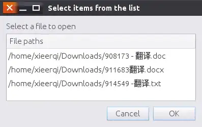

Select one, click OK. You will see a list dialog showing you want files are there for the tag you selected. You can select any single file and it will open with a default program assigned to that file type.

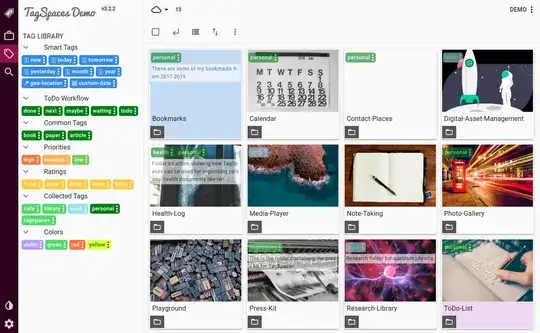

Another option I can recommend is to use the app TagSpaces. This app may save tags in the filename, which makes tagging durable and portable. You may edit the filename in Nautilus or within your Cloud-Storage and the tag will appear in TagSpaces and vice versa.
screenshot
