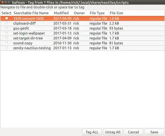

Bafman Begins
In response to the question I developed bafman (Born Again File Manager) which was only somewhat successful because there was little interest in the answer.
There are 13 screens in the answer, so here is one of them to give you the idea:
bafman 12
Bafman Returns
The bash code was posted in a separate answer below the first but revisions made it too large to fit within the 30K limit so the answer was deleted. If someone is interested in the bash script I'd be happy to resurrect the project and post it in github.

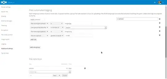

If the files you are looking to tag are hosted in Nextcloud for file sharing, then you can use the Nextcloud files automated tagging app along with manual tagging.
Automated tagging
The official description reads:
An app for Nextcloud that automatically assigns tags to newly uploaded files based on some conditions.
The tags can later be used to control retention, file access, automatic script execution and more.
It works for Nextcloud 12 and 13.
To define tags, administrators can create and manage a set of rule groups. Each rule group consists of one or more rules combined through operators. Rules can include criteria like file type, size, time and more. A request matches a group if all rules evaluate to true. On uploading a file all defined groups are evaluated and when matching, the given tags are assigned to the file.
Manual tagging
And here you can see how the manual tagging of files is available since Owncloud/Nextcloud 9.x using the file manager in the web view.
GOTCHA
If you wish to search the tags through the Ubuntu desktop file manager, then this might not work unless you use WebDAV to mount the network share and do something with the Nextcloud WebDAV API.
