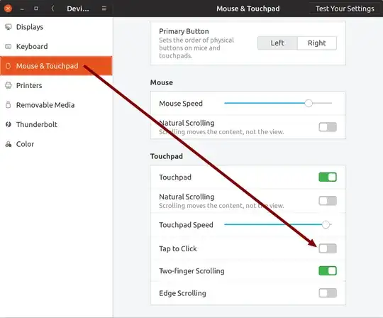

In Ubuntu 19.04, I found it was adequate (for my needs) to simply disable the "Tap to Click" feature:
However, the consequence of this, is that you'll actually have to use the touchpad's buttons (hopefully you have buttons) to do your clicking. For me, that's a fair trade-off.
If you don't actual have "left and right" click-buttons (separated from your touch-pad) you can instead calibrate the sensitivity of your touchpad. I learned about this from Peter Hutterer, in this bug report.
I wish Laptop manufacturers, didn't make laptops with non-receded touchpads. These touchpads that are level with the keyboard's keys (instead of receded) are a design flaw.
Please let your laptop manufactures know the trouble they've caused you by this bad design, else they'll blindly keep doing this in future models.
