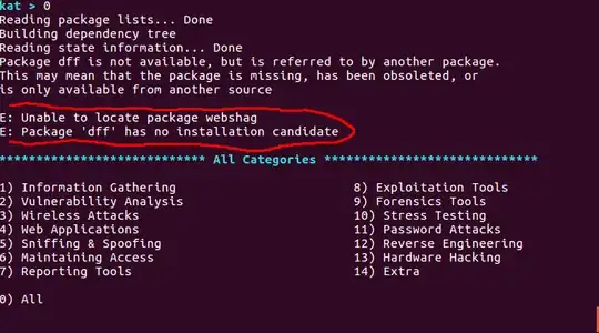

But after that I got this:
unable to locate package webshag
What do you want to do ?>

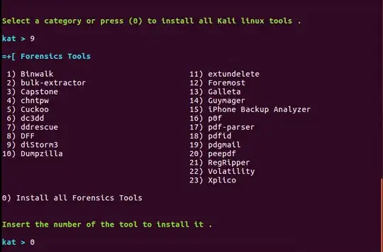

Press 0 to install all Kali linux tools.
When you go to View Categories and then enter 0 for all, the installer will immediately return to where you were. Scroll up, and you'll see that a number of the packages can't be found. Those packages are no longer maintained or have been removed from the Kali repositories. Even with this issue, you'll still find a lot of the Kali software available for installation.
So the best option is to install Kali linux tools in a series of distinct steps. Just like if you want to install Forensic tools on your system, then choose its option from the category and then type 0 to install all forensics tools. If this still doesn't work, then you have to install whatever forensic tools that can be installed one package at a time.

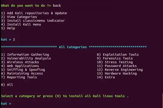

If you wish to go back to the main menu, type gohome in your katoolin interface. Now select the option 3 or 4 to install either the classicmenu indicator or the Kali menu. Press the y key to continue and then press Enter to start its setup.

In Ubuntu 16: edit file /usr/bin/katoolin and remove all references for the both packages: dff and webshag and save file.
Execute katoolin again - choose 1 and then 2 to update - after that type back and choose 2 and then type 0.
For me it still showed an error for usb-modeswitch for version 2.2.5+repack0-1ubuntu1, so I installed using this package from ubuntuupdates.org
After that I executed katoolin again - chose 1 and then 2 to update - after that type back and choose 2 and then 0 to begin installation.

I have faced the very same
Edit the file /usr/bin/katoolin (eg use sudo -H gedit usr/bin/katoolin) and remove those two packages, just search for text dff and webshag. Remove those two from apt-get commands too.
