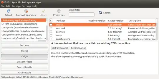

Install Kali Tools
Now open Synaptic Package manager and click on Origin. You can see 2 Kali repositories by names
LP-PPA-wagungs-kali-linux/raring
LP-PPA-wagungs-kali-linux2/raring
Click on the repositories and install the Tools from the list.
screenshot
