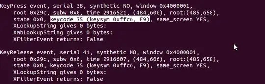

To simply swap two keys functions: From Terminal run xev and then press F9 which would give something like
Terminal window showing F9 KeyPress event

  • F9 = keycode 75
