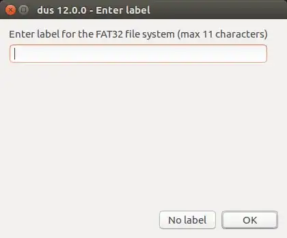

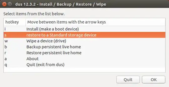

If the standard tools cannot restore the USB installer stick alias pendrive to a standard storage device, you can use mkusb-dus, which has a menu option to do it automatically,
  • wipe the first megabyte and restore the drive to a standard storage device (with the MSDOS partition table and a partition with the FAT32 file system).
See these links
There is a more general description of what to do, if you have problems with a USB pendrive in the following link,
