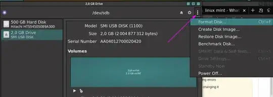

You could also try Disks again — but not with options from the gear button: from the top-right one (3-lines, 3-dots), namely "Format Disk".
There you can delete all partitions too and start again to a create a new one.
