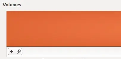

After that your USB drive is formated, but space is now unallocated free space. So you can't use it.
For allocating space you have to click on the + sign below the Volumes bar.
Then enter a name for your USB Drive and click create.
