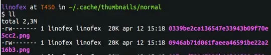

I finally solved the problem! The reason why I could not see png, pdf thumbnails was that my ~\.cache\thumbnails folder had only root privileges (I do not know why). After a sudo chown -R user:user ~\.cache\thumbnails, my thumbanails started rebuild.
Before changing the ownership:
After changing the ownership:
(look at total dimension)
