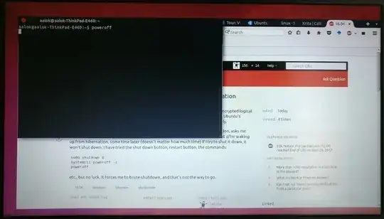

See the image below. It is the situation after I have run the command poweroff in the terminal. The screen has frozen and nothing further happens. Same things happens with each of the other commands mentioned above. enter image description here
