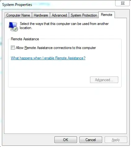

Additional information: On my Windows 7 window where you enable Remote Desktop Connection, there is only option to enable or disable remote desktop connection and it doesn't give you an option to select user.
I temporarily disabled the remote desktop connection as shown on the picture.

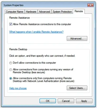

Your problem is that you don't have Remote Desktop on your Windows machine. You only have Remote Assistance, which is not the same thing. Here's an image of what that box looks like on a computer that is equipped with Remote Desktop.
The Windows RDC FAQ page states
You can't use Remote Desktop Connection to connect to computers running Windows 7 Starter, Windows 7 Home Basic, or Windows 7 Home Premium
Your best bet, IMHO, is to download tightVNC onto this windows machine and connect to it using Remmina and the VNC protocol.
